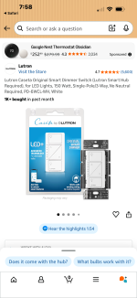

That standard Caseta Diva does not require a neutral.
DVRF-6LXX
Im finding that part# as being a dimmer.
Is there a Caseta part# requiring no neutral that’s not a dimmer.
Thank you.

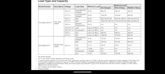

The neutral is required for the electronics to charge. The old models used the ground to charge the electronics. Very small capacitive current. Some motion sensors come with a green sleeve to put on the white wire if the ground is used. Same principle.
Caséta PD-5WS-DV switch does not require a neutral

I'll admit, I haven't used this model. I only came across it on the Lutron website. Looking at this chart, it may not work unless an LUT-MLC can be installed somewhere. It may be that it's not available anymore anyway if it's an old model like Curt mentioned.
