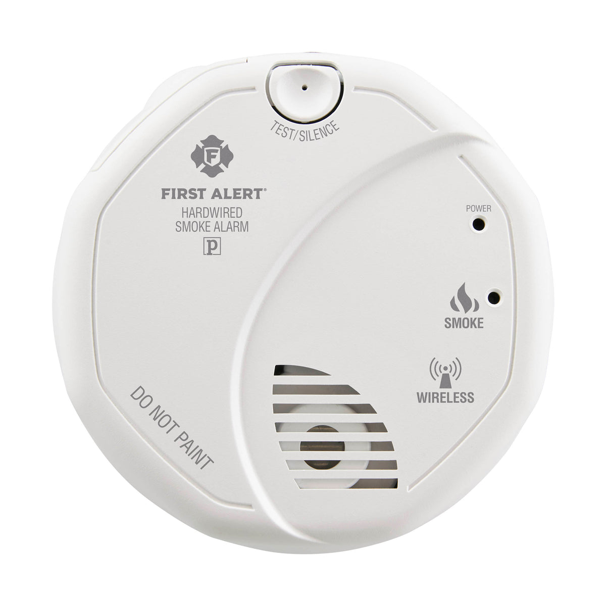

Just finished a 2nd floor garage addition and we need to integrate the 2 new smokes into the existing house, but running a wire isn’t possible.
is there a device that will wirelessly connect the two separate sets of circuits of smokes? Or do I have to replace all the smokes with wireless compatible units?

Absolutely. While build quality of the brand is poor, all the First Alert models that have wireless also act as a gateway to wired detectors. No extra "device" needed.

His issue was two distinct islands of hardwired detector interconnect.
Kidde & First Alert harmonized their hardwire signalling at some point some years ago. So there should not be a problem with one hardwire unit triggering another. On wireless interconnects it's definitely per vendor, and the big guys have changed protocols several times. The most reliable one in my experience was the old dip switch based Kidde. Now it's a bunch of button pushes and voice prompts and a royal PITA to get everything programmed reliably.

So basically the first alert models that have wireless will also still have the interconnect wire. So if it sense the trigger on the interconnect wire, it will transfer that signal over the wireless to anything paired to it. And vice versa?
Correct.
It's a two way relay. This is documented, but not clear. But I can verify having personally tested it both ways.
You need the models that have BOTH hardwire AND wireless. Two of those will bridge a wire gap.

Both Kidde and First Alert have full hardwired, hardwired power but wirelessly interconnected alarms, and battery powered with wireless interconnection models. X-Sense on Amazon also has some listed wireless options, if you want to trust an Amazon brand.
2024 International Residential Code​
R310.2.2 Alterations, repairs and additions.​
Where alterations, repairs or additions requiring a permit occur, the individual dwelling unit shall be equipped with smoke alarms located as required for new dwellings.
Exceptions:
1. Work involving the exterior surfaces of dwellings, such as the replacement of roofing or siding, the addition or replacement of windows or doors, or the addition of a porch or deck
2. Installation, alteration or repairs of plumbing or mechanical systems.
R310.4 Interconnection.​
Where more than one smoke alarm is required to be installed within an individual dwelling unit in accordance with Section R310.3, the alarm devices shall be interconnected in such a manner that the actuation of one alarm will activate all of the alarms in the individual dwelling unit. Physical interconnection of smoke alarms shall not be required where listed wireless alarms are installed and all alarms sound upon activation of one alarm.
R310.6 Power source.​
Smoke alarms shall receive their primary power from the building wiring where such wiring is served from a commercial source and, where primary power is interrupted, shall receive power from a battery. Wiring shall be permanent and without a disconnecting switch other than those required for overcurrent protection.
Exceptions:
  1. Smoke alarms shall be permitted to be battery operated where installed in buildings without commercial power.
  2. Smoke alarms installed in accordance with Section R310.2.2 shall be permitted to be battery powered.
