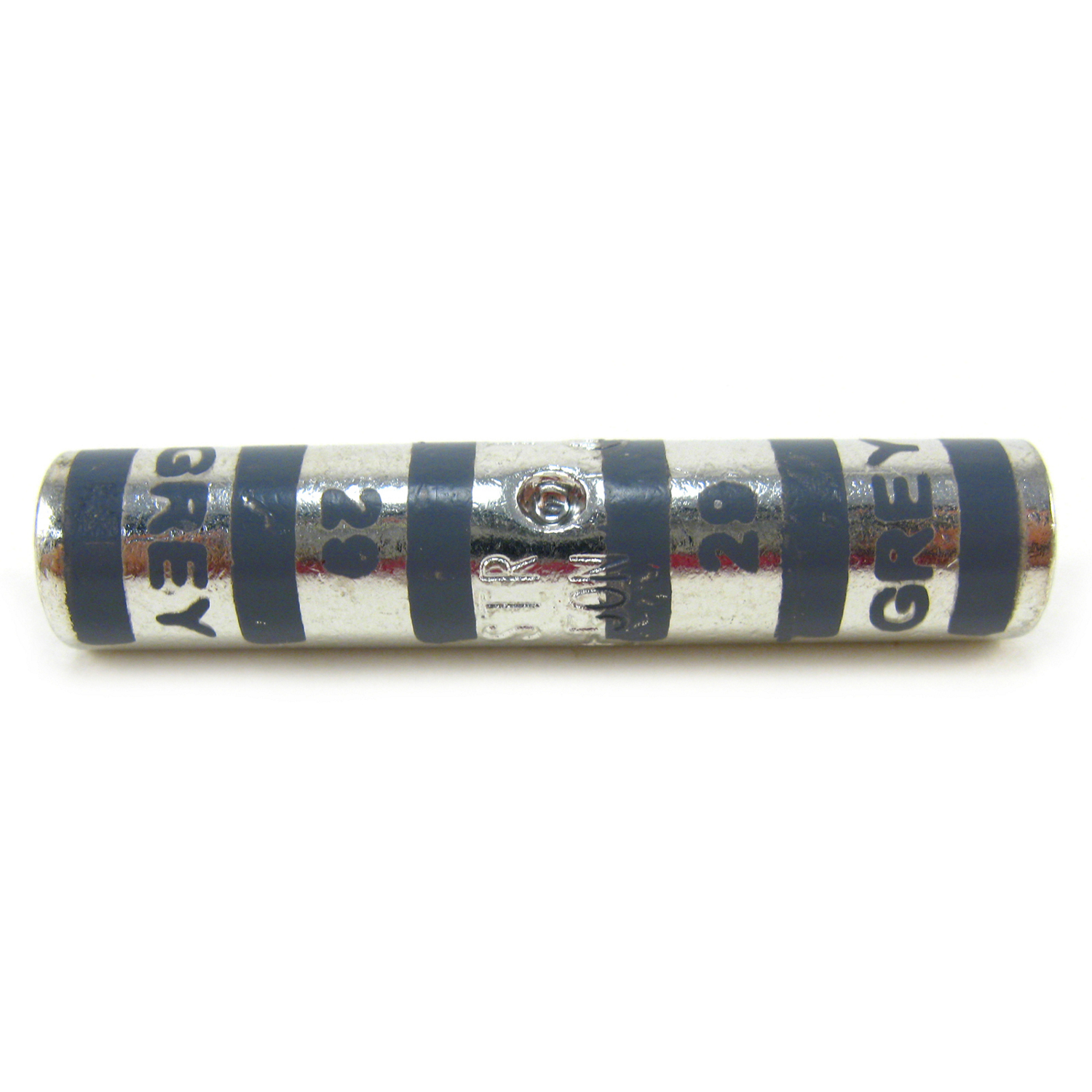

I made it 30 years into the electrical business without ever REALLY needing to splice a GEC, but there were plenty of times it would have been convenient. I had one of those instances last week and started looking at what tooling/connectors would be required to do this to code. It seems the cheapest you could get on the tooling was ~$1,700 for a hydraulic crimp tool that takes U-dies, then another $100 for the die (or $1,600 for a set to cover most conductor sizes). That's a lot of money, but not out of the affordable. I then went to look at connectors and the cheapest I could find was something like the T&B CTP22 at $40 per connector.
Am I missing something? Is there something SO special about he UL-467 listing that makes a connector cost $40 and make it so superior to a standard connector; let's say a color-keyed barrel splice? Or am I missing some cheaper tool and connector?

So, that covers the cost of the crimp tool. What about the insane cost of the connector. Looking at the CTP22, it sure doesn't look like it has magical properties relative to a color-keyed splice, other than the listing. My gut feeling is that a barrel splice meant for a single size conductor and with multiple crimps provides a better splice and a C-tap meant for a whole range of wire sizes.
ctp22_ck1
54806_ck1

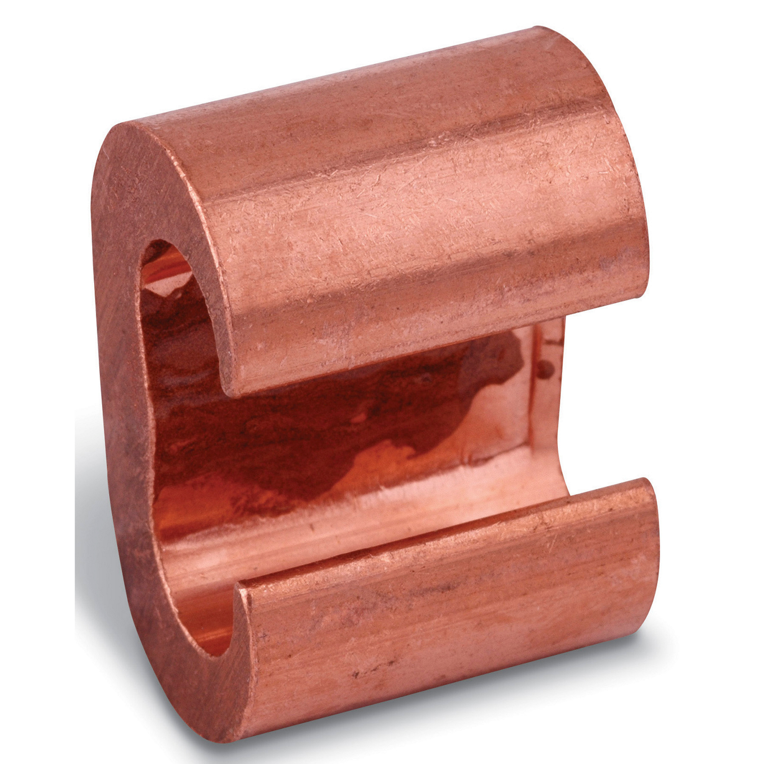

UL let's us see the UL 467 "Grounding and Bonding Equipment" Scope at their infonet. It's short and you can read it clicking here.
Now, the Thomas and Betts color keyed copper " C Taps " have a T&B catalog number of 547xx where xx ranges from 05 on up by increments of 5 and sometimes 10. The T&B C Taps have a UL Certifications (White Book) category of KDER, which is simply titled "Grounding and Bonding Equipment".
2011 NEC 250.64 (C)(1)
Splicing of the wire-type grounding electrode conductor shall be permitted only by irreversible compression type connectors listed as grounding and bonding equipment or by the exothermic welding process.
Now, to be clear, I came to the UL Category "KDER" by doing a manufacturer look up of T&B which lead me to a llloooooonnnnngggg list of product categories, including "Grounding and Bonding Equipment" with a UL File Number of KDER.E3060 which can be looked at by clicking here . About half way down the page you will find a sub grouping called "Ground grid connectors" which includes T&B catalog numbers 54705, 54710, 54720, 54725, 54730, 54735, 54740, 54745 and 54750. And just above this is the sub grouping "Ground connectors" that includes T&B catalog numbers 54755, 54760, 54765, 54770, 54775 and 54780.
250.64(C)(1) doesn't mention UL 467. What am I missing? Seems like the T&B C Taps work just fine for splicing a GEC.

Thank you very much for the extensive information. That's just what I was looking for. If I understand correctly, there are a bunch of things that are listed as "Grounding and Bonding" equipment, and UL-467 is probably just a higher standard for some who may want something with more rigorous testing. I never would have thought to dig through UL the way you did. Bravo Zulu.

This is kind of an interesting problem. A lot of people will look at a "UL 467" or "grounding and bonding equipment" search engine returns and take the silence about the T & B C Tap line as proof. Kind of like the certainty, in many, that a lowly #10-32 screw used to connect an EGC to a steel 4 x 4 box must be UL listed and it must be green.
