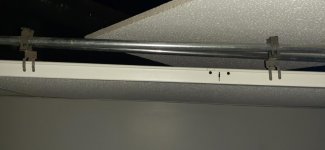

Per 300.11 (A) states, Cables and raceways shell not be supported by the ceiling grids. OK
Per 314.23 (D) (1) states, an enclosure shall be fastened to the framing members by mechanical means.
My interpretation is, a box can be mount to ceiling grids, but EMT can not be mounted ceiling grids, so would that make the picture a violation ???
Thank you, for any and all information.
