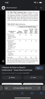

Table 430.22 E non continuous / continuous rated
Jpflex
Electrician big leagues
Victorville
This table does make sense in that it applies to determining percent of motor NAMEPLATE FULL LOAD CURRENT FOR OTHER THAN CONTINUOUS MOTORS but yet in contradiction it list a column for percentage of FLC for CONTINUOUS rated motors?
The table isn't for Other Than Continuous MOTORS. It's for Other Than Continuous DUTY.
Does your knowing that place you in a category above big league ? :)
Does asking this mean that you are all knowing? I believe the journeyman’s test is mostly open book because of the 1000s of codes and areas that some do not work in.
Big league = big transformers, high voltage and some line work. What category are you?
So continuous motor as on for more than 3 hours at full loaded current vs continuous duty or duty cycle on/ off cycles 100.% on time still is ambiguous on NECs part

A varying duty type motor but continuous rated motor
This description is ambiguous for the question below
