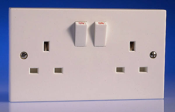

Are those the ones that you have to slide the little cover over before you can insert the plug? Or is child-proof diferent? The picture looked like a standard GFCI to me. I dont think the AFCI proposal for '08 will fly but the tamper resistant thing might be a good thing.
If someone could post a better picture I would appreciate it.
They have a shutter inside the hot and neutral slots that requires pressure by both prongs being inserted before the shutters will release. The UK receptacles have had this feature for a very long time.
mdshunk said:
They have a shutter inside the hot and neutral slots that requires pressure by both prongs being inserted before the shutters will release. The UK receptacles have had this feature for a very long ime.
Up till when I was there, only the MK 'Logic' and derivatives of 13A sockets had the feature implemented as described; all other manufacturers had a shutter that opened when the earth pin was inserted, as the 13A earth pin is longer then the other pins. The shutters have been a requirement on all sockets since the sixties.
The standard shutter is trivially defeatable for most sockets when you want to get a (example) European 2 (round) pin shaver plug (or test meter probes) into the 13A socket, a screwdriver (or nail file) would open the shutter. The MK one is almost undefeatable; only a 13A plug seems to do the job.
If you are now getting these then that is good. They should be fitted everywhere, really.
The other interesting feature is that the pins are half insulated, so you cant get a belt putting a plug in. Another neat feature, just made it to New Zealand last year...
Yeah, hard to tell on that pic, heres one that is definitely old style, note the nudger in the earth hole and the flat shutters.
Suspect that MK had a patent on their (what was) unique approach, which has now expired, and maybe many of the manfs are adopting that approach.
