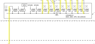

Using this as an example. There's an 800A main breaker being fed with 2 sets #500. The "branch" breakers in the panel and trip rating come out to about 875A. So is the calculated load the trip ratings?
Sorry calculations intrigue me but also confuse me sometimes.
Nope. The actual load on each breaker was actually taken into consideration in determining the trip rating of that breaker. The total load was used to size the main breaker. Think of it as your home panel. Several individual breakers each sized for the load with a main sized on the total load not the total breaker size. On your graphic there should be an accompanying load sheet showing the load on each breaker and a total load. The wire sizes should be based on those loads (adjusted to breaker ratings)

In this case with your diagram it involves tap rules so you couldn't feed the 100 amp breaker with 50 amp conductors even if the calculated load were 50 amps. You could use a 50 amp breaker with 50 amp conductors.
