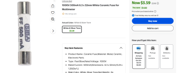

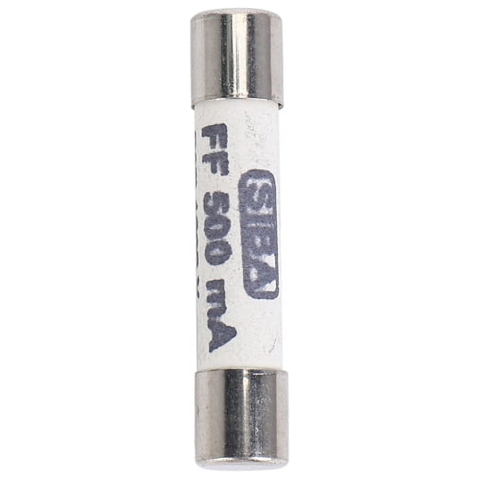

I blew the 500mA fuse in my multimeter. This is (obviously) for the mA/µA setting. There are a lot more and cheaper options for a time-delay fuse in this size and rating. Any opinions on whether using a time-delay for this small-range setting is hazardous?

Usually multimeters need very fast acting fuses to protect their electronic components. Such fuses are typically expensive, but still quite a bit less than a new meter to replace a broken one will cost.
If your meter has a CAT rating, I would stick with the recommended fuse.
Not worth possibly causing an arc flash.

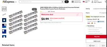

I've blown two fuses in Fluke 87s. One when I was doing something Gar told me I was an idiot for. Nicely put, but he was right. The meters and I both came thru unscathed. I'd be nervous with $0.99 fuses.
Ten for 99, that's only 9.9 cents per fuse

The one I need is a 5x20mm which returns even fewer search results that the 6x32. Taking mA readings on 12V or 24V control circuits seems pretty unlikely to cause an arc flash or other catastrophe. I understand the possibility of damaging the meter, but it's a fairly cheap Klein. I'm wondering if a time-delay would prevent blowing on a momentary lapse of attention or slip of the probes.
Yea, if you only use it for 12 or 24V, I would probably look for cheap fuses too.
But not if its ever used for commercial or industrial line voltage system. Although, if it doesn't have a CAT rating, it shouldn't be used on those systems anyway. Too easy to try and measure voltage while it's still set for a current reading.
