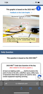

But the code of the day isn’t even about the lack of a bushing or fitting but instead about the nm cable not being continuous. Whatever this means?You need a clamp/connector, not just a bushing.
Yes:
View attachment 2569481 View attachment 2569482
No:
View attachment 2569483 View attachment 2569484
It says mechanically continuous which means that they must be mechanically connect to. The wording for mechanical continuity is directly from the NEC.But the code of the day isn’t even about the lack of a bushing or fitting but instead about the nm cable not being continuous. Whatever this means?
300.12 Mechanical Continuity — Raceways and Cables.
Raceways, cable armors, and cable sheaths shall be continuous between cabinets, boxes, fittings, or other enclosures or outlets.
Exception No. 1: Short sections of raceways used to provide support or protection of cable assemblies from physical damage shall not be required to be mechanically continuous.
