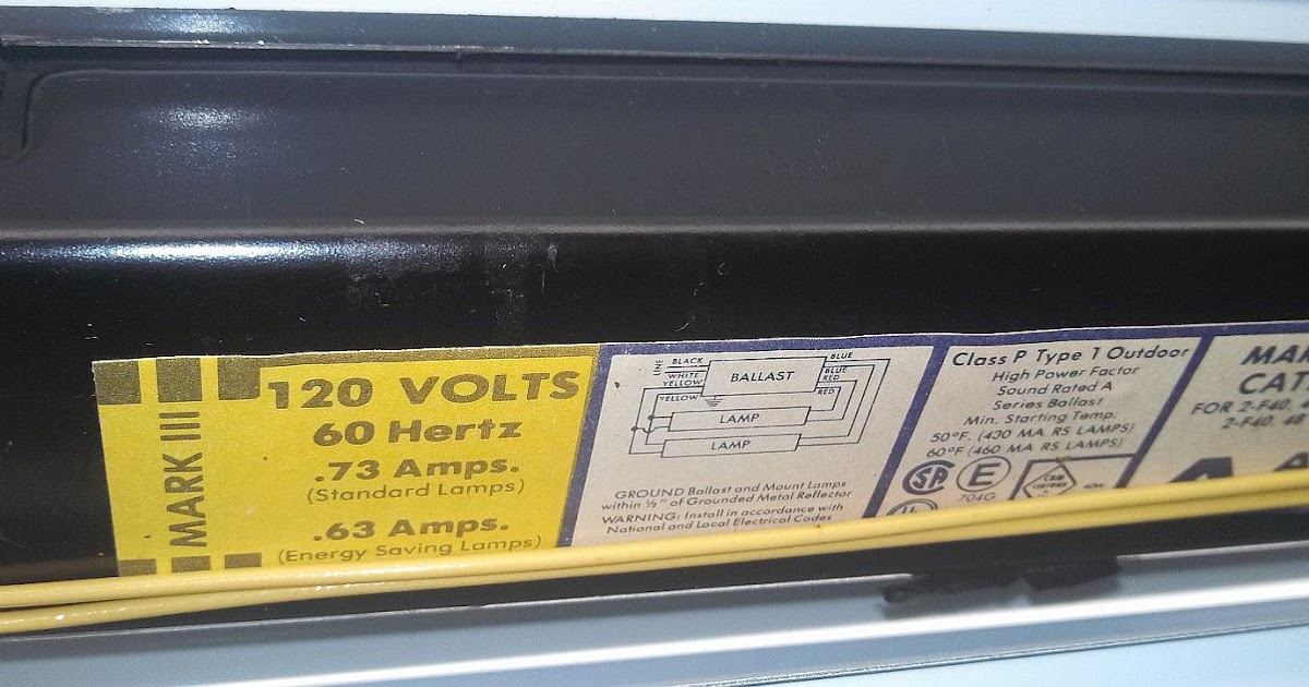

Found this, it may even interfere with vhf. See if that channel is in a different band than the others.
It appears to affect those channels that are 5.6 etc. I'll check more tomorrow.
I've noticed those channels come and go. I never knew the fixture influence until this evening. Just happened to be in the right place at the right time.

KNHL Hastings is what I think you're watching. They are one of the few stations still broadcasting on the low-VHF band (channels 2-6)...they are on "physical" channel 5, which is very susceptible to electrical noise. We also have a channel 5 broadcaster in our market...they also own a UHF station in the market and are rebroadcasting their 5.1 (ABC network) stream on their UHF channel to improve reception of their main moneymaker.

We rarely watch those stations because of the formerly unpredictable reception. We just happened to be watching when MDSW turned those lights on and about 5 seconds later we lost the channel.
