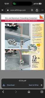

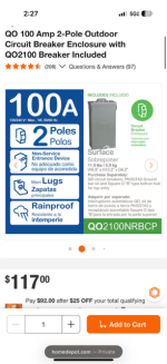

Thank your for clarifying I really appreciate the help!
So because the metal water pipe is considered an electrode I need to make the connection within 5ft of it entering the dwelling using 250.66.
the house emergency disconnect is fed with 1/0 largest ungrounded conductor.
I should be able to run #6 from
building or structure disconnecting means enclosure where located at the building or structure
Equipment grounding conductor run with supply conductors
One or more grounding electrodes- the ground rod at the emergency disconnect on the outside of the house?
Or do I have to get 6 all the way out to the service disconnect at the pole?
I would also need to install an I interbonding system on the 100amp emergency disconnect on the outside of the house?
