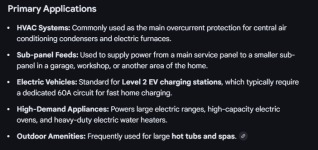

Unless it’s supplying two 120V loads, one on a 30A circuit and the other on a 60A. But I don’t think I’ve ever seen a 120V, 60A load.Well if one side is actually 30A and given the fact it's common trip it would never carry a 60 amp load period.![]()
In that case there's no reason for a two pole breaker.Unless it’s supplying two 120V loads, one on a 30A circuit and the other on a 60A. But I don’t think I’ve ever seen a 120V, 60A load.

I disagree. Maybe not the best "interlock", but if the 30 amp is supplying the air handler of an HVAC system, and the 60 amp is supplying the compressor, tripping the 30 amp would make it prudent to kill the compressor, too. Otherwise, the coils in the air handler may freeze and burst. If the 60 trips, shutting down the air handler makes the failure obvious to the humans involved.In that case there's no reason for a two pole breaker.![]()
