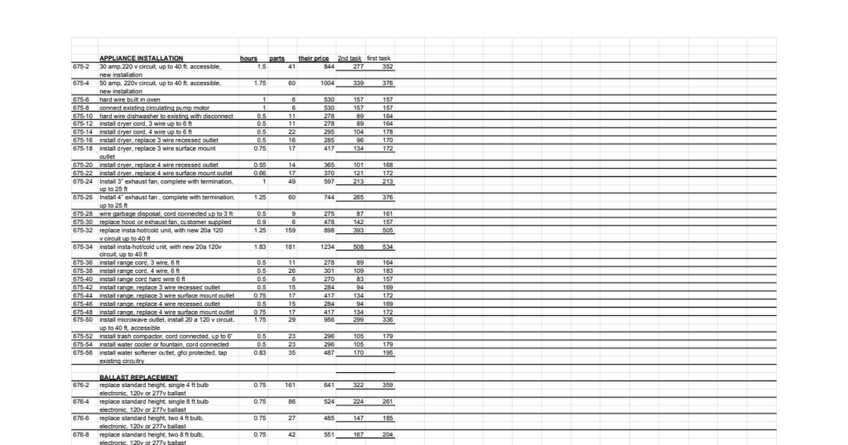

I found this one online. You have to adjust some things for sure (material) but it’s been a decent tool to use.
Some of those prices seems abnormally high. Like $700+ to change a ballast. I’m still trying to figure out the columns “their price”, “1st task”, and “2nd task”.
Is “their price” a competitors supposed price or the customer? Usually you just have a main task and then an additional task.
Most of the prices in there are almost double my book prices. Maybe it’s somewhere like NYC or another major metropolitan area. I’m not one to beat anyone up over price but man some of those are silly.
I would say those prices are on par with what a Franchise Electrical company would charge and I assume that would not be just a New York thing but a country wide price average. I think the "Their price" has to do with the price for a Tech to show up and do that one thing and leave. Maybe the other prices would be if multiple things are done?
I can tell you from being part of Mr Electric a few years ago, and in multiple territories, our prices were nowhere near those in that spreadsheet. Back then we were at $125/hr.
As for the tasks, we had 1st task and additional task. One line item would go as the first task, and everything else was billed at the single additional task price. I still use the MRE book, although I’ve edited it over the years. I scanned the whole thing and imported it to Microsoft Publisher to remove the MRE logos and be able to edit prices.

Can you explain the "Their Price" and "1st and 2nd price"
So I found this on Reddit and it came with the explanation that a guy worked at a shop that had somehow gotten a hold of a price book for a company like Mr. Electric that was in town. But come to think of it that shop also did plumbing and HVAC. “Their price” would be Mr. Electrics price and he said they had very few repeat customers in town.
1st price and 2nd price were the prices for the company he was working at that had adjusted the price book for their rate of 149$/hr. 1st task is the 1st thing you do on the job bad 2nd task would be all of the tasks afterwards. Parts is just the parts for the job. Parts on 1st task got a 30% markup and parts on 2nd and beyond for a 10%. Parts part was accurate enough I didn’t change much in the beginning but now with pipe and wire the way it is I am back to having to price the materials. I’ve been using the labor units and applying whatever markup I feel like at the time.
Ok, that’s sorta what I was thinking. But that’s also misleading because Mr Electric book has standard pricing and “member pricing”. The membership pricing is a discount plan sold to customers for a price set by the franchisee. My guess is that franchisee inflated their standard pricing to sell more memberships, but at those rates the discount would cover the cost of membership anyway, so maybe they were just hoping by handing out these memberships they were guaranteeing repeat business. Idk.
