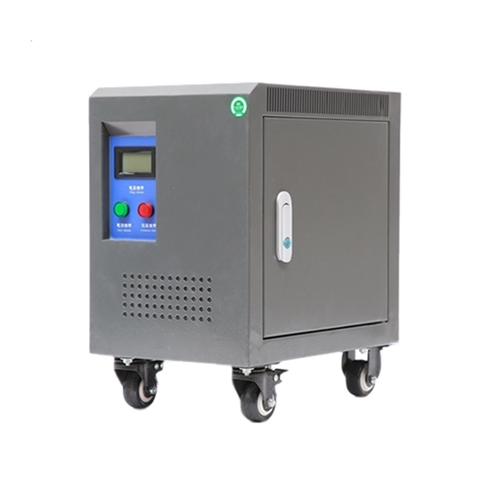

A 208 to 240 isolation transformer would be a waste of money and 24/7 vampire load.

Here is a partial of their schematic. None of the blue wiring is switched.
I feel like if I just have them change all the 1-pole breakers to 2-pole breakers then all would be good in the code and safety world?
But providing them a 208V with a bonded neutral would also work too?
I guess its 6 of one and half-a-dozen of the other.
I would do that and call it a day, but I have the maintenance contract on this stuff and have to watch out for my guys safety too.
