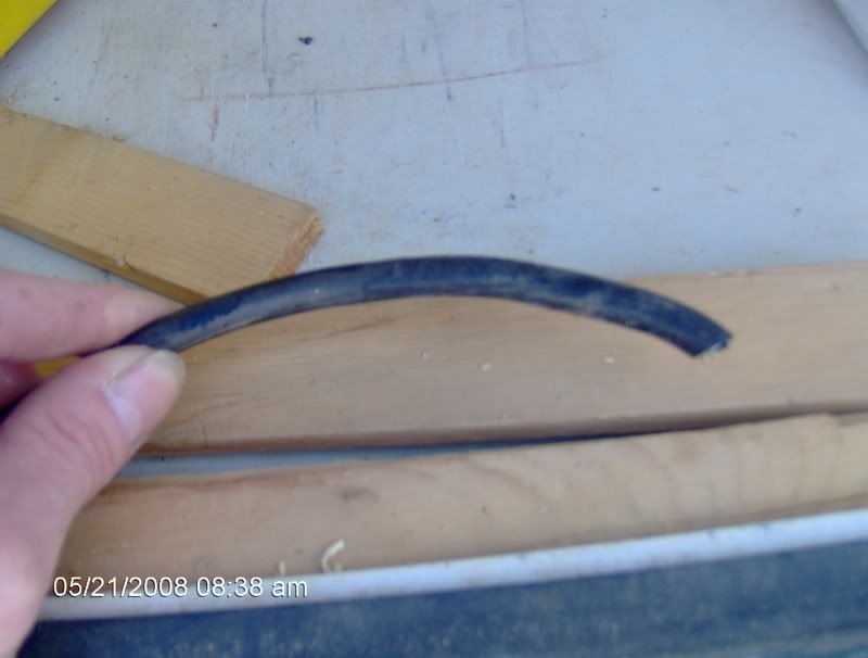

I just demo'ed a length of SO cord that was used to connect (1) 8' fluorescent light. The insulation was cracking the whole length, under the jacket. I could actually feel it as I flexed the cord.
Here are a few pics.
http://i125.photobucket.com/albums/p66/JohnJ0906/HPIM0454.jpg
http://i125.photobucket.com/albums/p66/JohnJ0906/HPIM0455.jpg
http://i125.photobucket.com/albums/p66/JohnJ0906/HPIM0456.jpg
http://i125.photobucket.com/albums/p66/JohnJ0906/HPIM0458.jpg
JohnJ0906 said:
I agree.
Was that really SO? Looked like a different cable, maybe SJO?
I guess I'm used to type W cable rated 2000-volts. I noticed the cable in these pictures appears to have a 300-volt rating. I will be interesting to go back and look at the jobs (marinas) I've been wiring in flexible cable (W). Maybe in 10 years or so?
