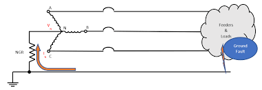

Do you have an example of conductor connections and components used for a LRG on MV? I'm guessing no connection to the MGN?
Just to be clear, MGN is different than LRG. If you have LRG, you don't have MGN, and vice versa. If you have LRG at source transformer, you typically don't (wouldn't ever?) bring out the neutral (direct from X0) with the phase conductors.
This snip kinda shows it. NGR = neutral grounding resistor
