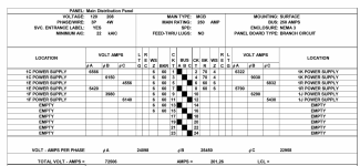

VA Calc
The 60 and 70 amp breakers are feeding sub-panels? Even with a calculated load of 201 amps 200 would work although technically not code complaint unless you can alter the loads slightly. Did someone check is 201 amps correct?
If the VAs shown are accurate, then B phase is most heavily loaded at 25450 VA, or 212A @ 120V.
However, Circuit 4 is shown as overloaded with 9030 VA on a 120V 70A circuit, which can only provide 8400 VA. So perhaps that is a typo.
Cheers, Wayne
Also, looking at the legend, I guess these are supplying 120/208 3-wire "single" phase panels. If all the loads are 120V, this VA method is fine. If there are 208V loads, then dividing those among the two conductors by take 208V * Load Amps to get VA, dividing that by two, and assigning half to each conductor is non-conservative. A conservative method would mulitply the 208V current by 120V and assign that value to each conductor.
Lastly, the breaker size for the 1J power supply is missing.
