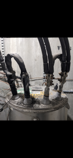

Wouldn't it be half the FLC? Here is what SCL does: you can't see because of the insulation, but it's a braided copper jumper. Not sure if these will provided with the transformers or added in the field.
You could be right. The only way to know for certain is a photo of the nameplate. One of us is probably right.
