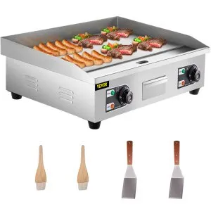

I have a griddle, the nameplate states that it uses 3.2KW on 120V power. I am thinking I need to install, a 35A breaker, 8AWG wire, and a 40 amp flush mount plug to service the unit. Does this sound correct to you all? Thanks.

Does it come with it's own cord and plug? If so my guess is that a 30 amp circuit is what's required. This a Vevor griddle correct? I see that they're listed as 110 volts which would mean a higher output/current on 120 volts.

The Q&A on the spec page says the unit does not come with a plug and that an "air leakage switch" should be installed. I've never heard the term "air leakage" switch, I have heard of just an air switch, which is mostly used on garbage disposals.
Another thing I noted was the spec sheet said 3200W @ 110V, then went on to say it used 31A. My math says 3200W @ 110V = 29.09A

It comes with a cord, but no plug on the end. I agree

Yeah, I've never heard of that air leakage switch either, I read that. This griddle is in a convenience store kitchen. They had it sitting there with a 15amp plug on the end of it and was intending to use it on a 20amp 120v circuit. I told them the circuit isn't large enough and we will have to upsize the wire and the breaker, along with the plug on the end of the griddle cord and the plug in the wall.

yes it is a vevo Griddle, model number: LD-610

There is no 80% rule for this appliance. Since it has a thermostat it will not remain on at full output for 3 continuous hours and is therefore not a continuous load. If it draws in excess of 30 amps @ 120 volts you will need a 40 amp circuit with a 50 amp receptacle and plug.

Nema 5-30 (straight blade not twistlock) is the thing to use here so the cord hangs straight down the wall.

That's a real oddball to operate off of 110 volts at that wattage and no UL. I would tell him to sell it on eBay and get a real griddle made to be used here before he burns the store down.
