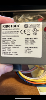

If most of the cable length would be in a switch loop, then having that switch loop drive the coil of a RIB relay is one option to reduce voltage drop. Could reduce the need for buying more copper.

I see that retirede answered the question concisely, but here's an example:
Say the source and load of a lighting circuit are in relatively close proximity, but there's a switch loop that's hundreds of feet long (perhaps to accommodate several 3 or 4-way switches that are at some distance apart). As a result, there could be a lot of voltage drop if the switch loop conductors carry the full load current. However, contacts in a RIB could could be used to close the circuit between the source and load directly without any of the load current going through the switch loop conductors (they would just need to supply current to the coil of the RIB).

I'm a box of rocks, why would a RIB change anything about a voltage drop calc?
Think of the way a garage door opener works.
You power the opener at the ceiling, then have a low voltage switch turning on a relay coil built into the opener.
The controller wiring isn't part of the 120v circuit. Thus, distance matters much less than if you switched the 120v power - especially on 250 ft

I bought this RIB relay RIB01BDC that my supply house recommended but looking on line Functional Devices I'm not sure it is the right one. If it is the right one, I still don't know how to wire it for a 4 way long distance situation. Any help is appreciated. I tried to photo it but it said too big of photo to attach. Thank YOU
