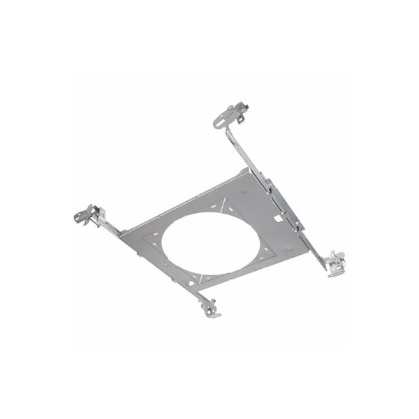

For new construction some manufacturers make mounting plates that the box attaches to. I've used the mounting plates from Halo and they work great. As it stands now every boxes needs to be mounted so these types of light definitely need a code update regarding the boxes being left floating.

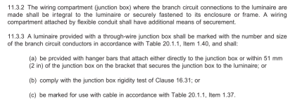

Wafer lights fall under recessed lighting which would be UL 1598, I am not aware of anything in UL 1598 that would allow a junction box to not be well secured, my guess is any instructions that say otherwise indicate the fixture is not really listed to 1598, which may be possible as there are other standards and fakes out there. Or possibly the instructions were not included with the listing.
My copy of 1598 is a bit old, if you want the most up to date info you can search on ul.com look for 'free access' but my copy contains this section:
Regarding box fill they also have a method for that in the standard.

Depending on what brand you use there is a code compliant way to install these in a 2x2 grid ceiling. Halo makes these. I've used dozens of them with grid ceilings and they work very well. Has a provision for mounting the box directly to the frame.
