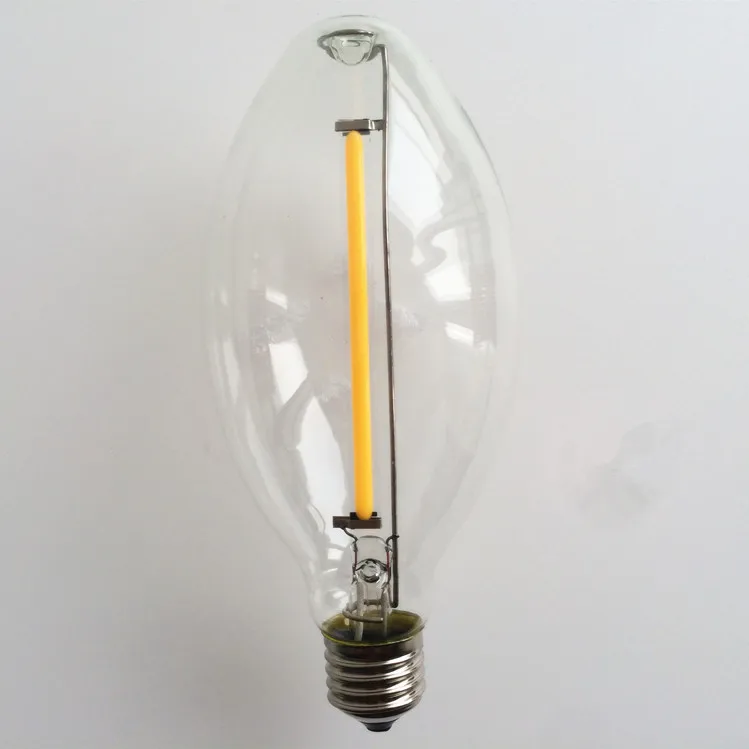

Will mercury vapor lamps ever make a comeback? Thoughts? :?
Probably not. LED lasts longer, way more lumens per what, instant restrike, mercury free and better color temperature and CRI. As is there soon going to have a LED filament substitute:
1X-E27-10w-led-filament-lamps-220v-Big-led-filament-bulb-led-bulb-ED80-Replace-Halogen.jpg
