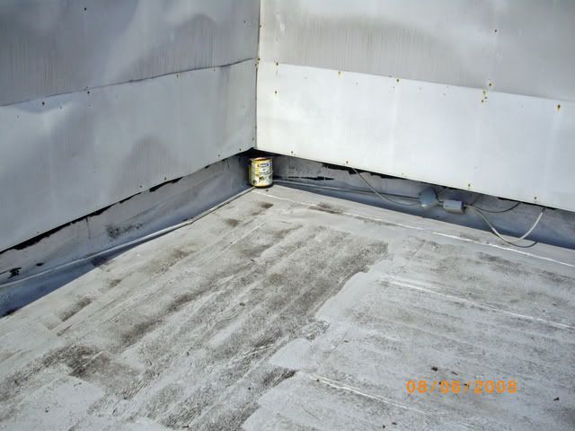

On this subject, but off on a slight tangent, how does one evaluate components to determine if they are intended for wet (in my case, outside roof top) locations.
Cases in point: Fluorescent fixture behind a fabric canopy sign - totally exposed at the top to the elements (1st photo below).
Cable directly on the roof (nice use of a paint can for ballast, eh?).

If it is in a wet location it must be listed for wet locations.
If it is in a damp location it must be listed for damp or wet locations.
Just by looking at the pictures I can tell you that the junction boxes and EMT fitttings are not rated for wet location.
As far as the conductors, you could open a JB and see what type conductors were used.
All in all a pretty crappy installation, and definitely not code compliant.
Just my opinion

Is there any way to make this determination on items in service for maybe 20 years or more?
You need to look in Article 100 for the definitions of location, wet and location, damp.
