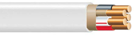

I have been calling around trying to find a roll of NM 14/4. A local shop says they have "14/2/2 double neutral". My understanding is that 14/4 is black, white, red, blue, bare and 14/2/2 is black, white, red, white with red stripe, bare. I asked the shop to confirm if the second white was striped on the "14/2/2 double neutral" and they took a look at the cable and said both whites were unstriped.
Is this a thing? Why would they not stripe one of the wires?
Also, similar question - is my understanding right that 14/4 is meant for 3 way switches (to stay compliant with 2011 NEC) and 14/2/2 is meant for running two separate circuits?
