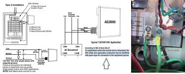

Those little external SPD's for HVAC equip etc. sometimes come with a green or white wire. (When Mars split with Intermatic they changed their knock offs to use a green wire). On the Intermatic's (etc.) I just slip on green shrink so I don't confuse any one. They mention this in their instructions. (bothers me too).
If it's dual function, maybe make that conductor Green with White tracer or vice versa.
Jap>
Was curious to read article 285.27, that Intermatics instructions reference, and I see it was moved to Article 242 in the 2020.
“ 242.30 Connection Between Conductors. An SPD shall be permitted to be connected between any two conductors — ungrounded conductor(s), grounded conductor, equipment grounding conductor, or grounding electrode conductor. The grounded conductor and the equipment grounding conductor shall be interconnected only by the normal operation of the SPD during a surge “.
