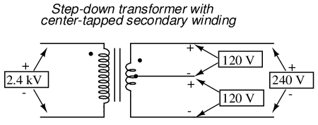

When dealing with US electricity, Single phase for residential and commercial should be considered "Split Phase", where 1 single phase winding in the transformer is tapped [or split] in the middle and grounded - so in reality you still have 1 winding - making it 1 single phase. 2 phase is totally different and should not be considered the same.
Heres a good diagram:
Looking closer at it, the polarity is incorrect, but the single winding and voltages are correct. For this topic, it should suffice.

How about two hots on a wye system? Single Phase?

2 Hots from a wye would be a single phase. The 2 hots use 1 winding of the transformer, even if it is a 3 phase transformer, you are using 1 phase.

Wouldn't a WYE transformer use two windings for a single phase circuit utilizing "2 hots"?
Hmm, you sure are right - I was thinking of delta. OOps!
In that case, the 2 windings have a 'center tap' being the grounded center point, so its still somewhat similar to a single phase center tapped transformer. In any case, you arent using all 3 windings, so it isnt 3 phase, it sure isnt 2 phase, so by default it should be considered single phase.

two hots on a delta would be using one transformer , but could have no center tap.
