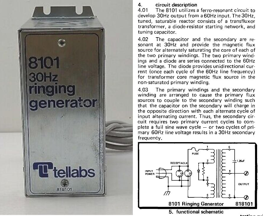

The main benefit is the ability to change the frequency of the AC output, which you cannot do with a transformer.
Well technically a ferroresonant transformer can change AC frequency, they are not used in motor controls that I know of though.
I have seen them used to change 60hz to 25hz.
I thought those only maintained a constant secondary voltage with fairly wide changes in the primary voltage.
How do they change frequency?

I've not done a detailed analysis, but I _think_ that ringing intentionally uses saturation effects to act as a frequency divider. There are two primary coils, and they alternate which one is saturated and just passing current without generating additional flux in the core. The secondary coils are alternate polarity coupled with a tuned capacitor. Net result you get exactly 1/2 the input frequency on the output.
In general transformers (or other linear circuits) cannot change frequency, but with clever tricks which depend upon non-linear effects you can get harmonic multiples or submultiples of the input frequency.
But yes, the most common use for ferro resonant transformers was voltage regulation.
