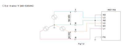

I went to the datasheet, and there are 3 different connections diagrams.
480V wye, 240V delta, and single phase.
From these diagrams, I think we can infer that there are 3 separate single phase inputs, rated 196-305V, that the N terminals can be up to 120V different from ground, and that the L terminals can be up to 528V apart.
In the 480V wye configuration there is a chance that the neutral is necessary to force balance between the separate inputs.

From the wiring sheet the op provided, the loads are single phase, 305 volts or less, so no 480 loads, that is why they want the 277 volts, it’s not just the controls needing the neutral, all loads need the neutral. If a neutral is not available, they would need a 480 delta to 480 wye four wire transformer if an existing feed is used, unless a new circuit or feeder is installed from where the neutral is present.
Thinking on this: we have a strong guess that the power supply is 3 separate switching rectifiers operating with their outputs in parallel, and sharing the DC load.
If everything is perfectly balanced, this should also be a balanced load on the 480V side, and virtually no current should flow on the neutral.
But these are three constant power loads, if the input voltage drops, the input current rises. This means that the input impedance changes as the square of the applied voltage.
Without the neutral reference present, the system is in unstable equilibrium. Say a random fluctuation drops the voltage to one leg: that leg will try to draw more current, and its voltage will drop further. Pretty quickly one of the internal power supplies is operating near its minimum voltage and the other two are in an over voltage state.
But with the neutral present, everything stays close to balance and little current flows on the neutral.
Speculation: the neutral reference could be supplied by a small zig-zag transformer in the machine, with a pure 3 wire supply external to the machine.
This would address installations where the service is grounded wye but the neutral is not brought into the plant. It might also work with corner grounded or ungrounded systems, but that would require additional evaluation of the insulation system between the circuit and ground.

From what I gather, it’s around a 20 amp circuit, so it’s a toss up, depending on where the panel is, will a neutral bar need to be installed? Is the panel next to, or in the service equipment, or remote, and neutral would need to be pulled in existing conduit?
The OP is proposing a piece of equipment that might go into a number of different facilities. So this is more of a survey about how common 480V (no neutral present) is vs 480/277V, not selecting a transformer vs running a neutral for a specific facility.
