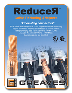

I am working on a project which requires a 480 / 277 volt sub panel. Due to voltage drop we are using 600 mcm thwn wire. The 400 amp breaker (feeding the sub panel is a Sq d I line series) has a maximum wire lug size for 500 mcm. Is it code compliant to splice the 600 to 500 for termination to the breaker, or is there another solution?
You could use a crimp on adapter like this in the correct size:
https://www.platt.com/platt-electri...luminum/Ilsco/ACM-350/product.aspx?zpid=29088
Infinity never seen those. Is that something new. I'm going to ask my supply house about them. Could of used them a few times.
I think they have been around for awhile, I web then used in a sweet of gear that was at least 20 years old. I have never used them though, I always wondered if they make a good connection to the beaker since its a solid piece is aluminum vs the wire stands that smash into shape when torqued.
If it is similar alloy as the lug they will expand and contract at same rate won't they?

As an electrician in the US I could not do that without the parts being a listed accessory for that breaker ....... or the AHJ approving it which would be doubtful.

We have crimp tool for that. I think it was pricey. More than a few hundred.
I had to crimp 3/0 to fit 100 amp breaker. The tool crimped a cone shape 3/4 of the way into the wire. Be carefull that theres enough spacing for the crimps to be side by side going into the breaker
The OP said his breaker was I-Line construction, therefore the limiting factor will be the wire bending space. The offered 'reducers' will most assuredly also have space issues.
The breaker normally has field changeable lugs that accept 600kcmil, and can also be connected to bussing, but none of these options fit into I-Line panels. Surprisingly(?) a larger frame size (e.g. 1200A with 400A trip) would have 600kcmil as an available option in I-line construction.
Bending space would be a limiting factor to what NEC would let you install, will not change what size lugs are in the breaker used.
The lugs will depend on what breaker is used, there is more then one 400 amp breaker. Just some fairly common examples from the catalog would include the LA/LH series with lugs accepting 1 -600 or 2 - 250's or the LC/LI (which is a 600 amp frame) accepts 2 -500's
At the bottom of the chart is a note telling you to go to a different page for optional lugs, which unfortunately I think sent me to wrong page, but I believe it is sending you to same options as there is for the general use L series breakers you just have the plug on bus end for I line that is not changeable the other end is same as other L series - or for within any other series for that matter.
