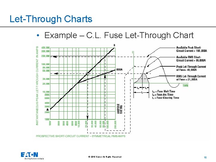

Testing of breakers/ fuses was taken from thousands of data from experiments. The reason I saw why 0.15 PF lagging was chosen could be that it was the lowest possible power factor that their testing equipment can provide. If you want, you can go lower and test breakers at 10% PF and achieve the same goal as our pioneering engineers had.
The engineers before us did those tests to establish the line A - B in the graph of the fuse instantaneous peak let-through current versus the prospective short-circuit current using the circuit which exhibited a 0.15 PF. The thermal energy developed doing test A was observed to be 1/123 of the thermal energy developed in Test B conditions.
