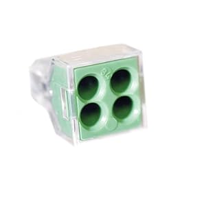

will some one post photo of wagos, I dont even know what that is :-?
Sure, here ya go

I do question the idea of wagos. Back about 15 or so years ago our duplex receptacles had that type of connections and then they said #12 is not ok as a back stab. Now we use same idea and call it a wago. Give it time and they will likely have issues too. I am from the old school of strip it.twist it, put a wire nut on it. You can see your work, easy to undo, and almost never a problem. To each his own. Only look at the bottom line. What ever works best for you money and time wise. If service work i do not want to go fast.

Im with you jim I never trusted the push in's . It is a small contact area on the spring and it does not put much pressure on the opposite side. I would never fed a recep that way , if they come on a light fixure I can see it on a lighting load , maybe

Legal or not it is very costly to you if even 1 fails and cost you a call back. Care to explain to the customer that his new house you just wired has them in every box after he just seen you replace 1 that failed ? I know the fail rate would be low but it likely is a lot higher than a wire nut. I look at it this way, i strip about 1 1/2 inches off wire, twist with klines so i have a good connection even without the nut. After twisting i cut them off to about 3/4 of inch then add the nut. Short of solder this is about as good as it can be.
If you think the mechanics behind a receptacle backstab and a 'Wago' spring connector are the same, then you are sadly under-informed. Take the time to read both technical reports and testing standards for spring connectors.
While, I have no problem with the performance of spring connectors, I do view them as simply one of several acceptable methods.
They both are very similar. Gladly read them if you have link.
Lets not forget that thru the years we been lied to many times. Think back to the late 60's with aluminum wire and back when #12 could be back stabed on receptacles. We were told they were good too but now paying the price. Your welcome to use them but i never will. Got to admit they would be faster. Problem is a customer gets 1 year of warranty on new house. After that year the problems start costing them not you.
