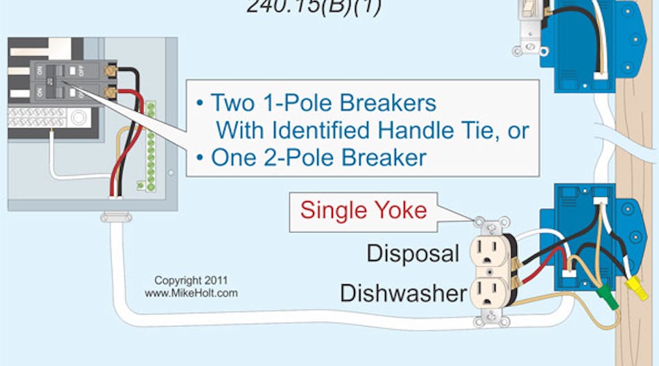

2-gang single receptacle plates are only available at certain electrical supply houses. A colleague of mine said he has purchased them in stainless steel at Lowes. When I inquired about them (as I could not find them where my colleague said they were at) the electrical department employee insisted that they are not allowed per NEC anymore. I find that hard to believe. The most common configuration I have been utilizing the past several years is a 2-gang box, either plastic or metal w/2G ring -preferably deep(er) ring with (2) separate #12-2 NM cable branch circuits ran back to loadcenter utilizing dual function AFCI/GFCI circuit breakers. And if no 'air switch' is used the a #12-2 NM switch loop up to a 20A switch on wall next to sink. My question is: Why is this Lowes electrical department associate insisting that they do not carry "2-gang single receptacle plates" anymore because they are "not code compliant"?
