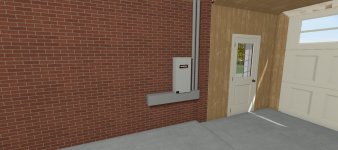

I have no experience with solar whatsoever. I am still in the process of rebuilding my house from Hurricane Helene, and now that there are no trees around my house, I have the potential for a solar install.
My question is, as I'm getting ready to build the new service on my house, what should I do now to make future solar service equipment install easier? The exterior service will be a 200A meter and 200A disconnect, nippled through a 10" brick wall to the interior side of the garage. Inside the garage I'm going to have a trough w/ a transfer switch mounted above and a couple of pipes going into the attic (one routed to load center, one routed to generator). Is it as simple as adding a couple extra conduits to this trough for future solar equipment? Render attached of what interior side of the service will look like (in case my wife sees this post, yes all of that will be paint matched to the brick). That wall steps back in about 10" so this stuff won't be protruding into the path a car pulling in.
Georgia Power limits residential installs to 10kw.
Thanks.

"Straight" solar (no batteries) is pretty simple. For a 200A/200A service you can just mount a breaker in the service panel at the opposite end of the bus from the main breaker and connect up to 32A maximum current (40A breaker). But 10kW would produce about 42A of maximum current, so to connect that much you would have to connect it to the line side of the panel on the service conductors or reduce the rating of the main breaker to 175A.
If you are thinking about including batteries for backup during an outage, that's a whole different ball game.

(1) Arrange to have a 200A feeder segment that supplies all the loads you want backed up by battery and nothing else. This feeder segment would get intercepted for the battery gateway (equivalent of transfer switch) and the connections of the battery and PV inverters.
(2) If you have both battery backup and a generator transfer switch, you need to decide what behavior you want when the POCO goes out. One simple configuration would be first to use the batteries; then if they are depleted, the generator transfer switch sees loss of power and switches to generator. For this configuration your 200A feeder segment in (1) would need to be on the supply side of the generator transfer switch.
[Seems like this configuration may be prone to yo-yoing--i.e. batteries get depleted overnight, switching on generator; sun comes up and starts charging the batteries; the transfer switch sees power switches off the generator; but the batteries haven't charged enough to carry the load and then switch off. So some controls would be required to prevent this.]
Another configuration uses a battery back up system that knows about and can control the generator to charge the batteries as needed. In this scenario, your generator transfer switch would not be required.
Cheers, Wayne

So my intent with the trough in the garage was that I could intercept the panel feeder there, and also put batteries on that wall. My intent for now is to put whatever conduits I would need to get power from the panels to the battery/inverter setup in the garage. Currently will have (2)x 2" for generator & main panel feed to the transfer switch. If I added one more 2" do you think that would be sufficient? It would be at least another year before I can even think about solar. Once I get the house done, my next focus is to fix my yard and pool area.
Do you mean a 2" to the roof, to connect the modules on the roof to the set up in the garage? Getting a 2" raceway up to the roof could be unwieldy. Typically a 1" metal raceway will suffice for most residential installs to contain the conductors coming from the roof(you could even run 2-1" raceways if you'd like), just be sure it is a metallic raceway to cover NEC 690.31(D)(1) in case you run DC through it.

Your needed prep is going to somewhat be dependent on the brand and model of the inverter and storage you select. And if you are planning on a fossil fuel generator, how that is integrated is also dependent on the solar equipment.
If I were you, I would get the design completely down on paper in a single line, with all details specified and with brand and models chosen, before running any conduit and installing any troughs or transfer switch. This will flush out details for you that will help you even if you decide to change something later.
Some details that will guide your design:
Is your home all electric? Are you wanting to back up the whole main load center, or will you have two load centers, one with all your lighting and critical ckts and the other with stuff you can live without in an outage? If the backup needs are not that great, you might consider forgetting about the generator and adding more battery.
With generator and solar, what is the generator backing up? What would solar with batteries back up? You need to understand the limitations and behavior, and the connectivity/architecture requirements of the solar hybrid inverter you are considering when integrating with a generator.
Each company has a different philosophy/architecture. SolarEdge makes their Backup Interface for the Microgrid Interconnect Device(MID), Enphase makes their IQ System Controller, Sol-Ark can pass through 200A, but really needs a separate bypass switch as well. Other solutions have different needs, and all these may result in different conduit and connectivity and space requirements.
No just to the attic. The service equipment will be difficult to access one construction is complete. I was going to run some conduit from this trough up to a more accessible spot in my attic.

If the conduit to the attic is for conductors to the array, and those conductors will be DC (if you are not using microinverters and AC-coupled batteries), then those conductors can't be in the same trough as your AC conductors, per 690.31(B). You'd need a dedicated metal conduit path from the roof to your inverter.
I don't have the experience to advise on size and number of conduits. Seems like you could draw up 3 one-line diagrams at the moment, one for pre-batteries (assuming that will be the immediate implementation), one for Schneider Pulse, and one for Generac PWRCell 2. Then look at the variation in what you'd need and pick a trough/conduit install that is flexible enough for any of the 3.
Cheers, Wayne
