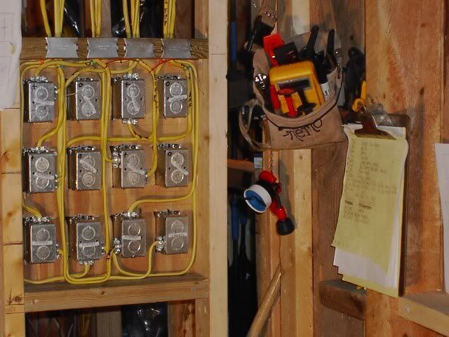

I take it you never stapled 2 wires together in the eaves of an attic.
Splinetto you obviously can do as you please but to condemn someone elses work for being code compliant is not right. If you can show it is a violation of the NEC then show it don't sit there and say you think it's wrong.
You must like to overreact alot if you think I was condemning his work .. Dont be so sensitive...On the otherhand why do I have to prove 1 per 1 is right why dont you prove it is Ok to have cables supporting each other and multiple cables per hole?

I don't think anyone will agree with your view that the cables are supporting each other and because that is not how the NEC works.

The cables must be supported...And my opinion is that whatever the cable is resting on is supporting it...The hole is supporting a cable that is supporting a cable and so on

I can almost sense some of you all coming over to my side
splinetto said:
300.11(b).......or am I missing something?
No, I am missing something here. Actually, I guess I have no right to add to this being unfamiliar at the moment on that exact code, but here it is.
Why are you saying cables are being supported by cables? In that scenario, the cables are considering being supported by the bottom of the hog hole, are they not? I'll have to try and find some old pic's I have. If you are saying that is a violation, than I should of been shot long ago.
At first it looked like there was CAT5 in the run with the NM, that's one thing, but too many cables in the same hole? I'm left scratching my head:-? Nothing was EVER said like that to me in the resi's I have done!
