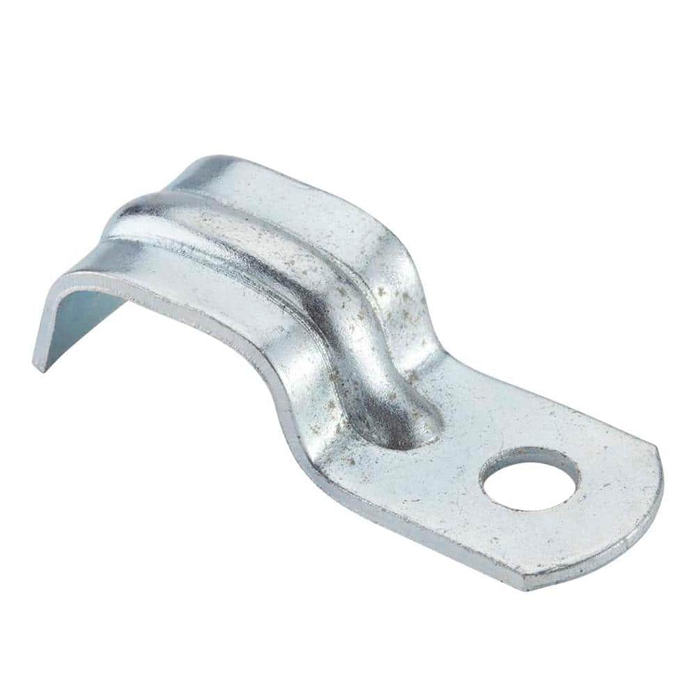

12/2 UF wire in 1/2" PVC

Because its underneath a trailer that has a steel bottom. nothing to staple to.

Can you replace at least 1 TA with a cable clamp, so you have a bunch of glued together physical protection items rather than a conduit run?
I could. I have 2 junctions in the crawl at fs boxes If i put 4 in (2 on each box) that would make every end breathable. Would that work?
How far of a gap should I leave between each pipe and the fs box? Enough to get a strap within 8 inches?
12/2 uf is 463X183 mils according to southwire. So it is .07 sq. in which means it should fit. I used to sleeve 2-12/2 nm in 1/2" but that was a bare

IMHO in the situation that you described, the PVC and the UF were actually a good combination. What I suggest you might have done differently was to run the UF from the first box stapled or whatever to get from the box down to the metal below the trailer, then simply gone into a PVC sleeve for the length of the run, then exited the PVC and returned to stapled fastening going to the second box.

sometimes there is a gap between top of beam and underbelly so cable can go over beam instead of under
and wooden wedges top of piers to staple to
