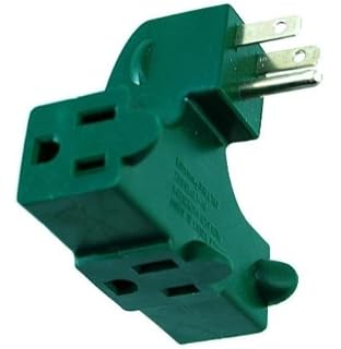

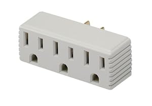

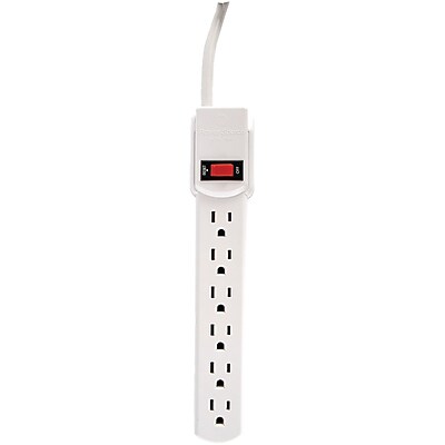

Any receptacle circuit, general purpose or individual can be overloaded. It is not a safety issue.
The fact is, there are no words in the NEC to support an inspector prohibiting more than one receptacle on an individual branch circuit. To do so is without a doubt making up their own rules.
And for what purpose? Is there a safety issue now? If it is a safety issue will the use of a single receptacle change that?
m000036843_sc7
To me it is a ridiculous thing to worry about when:
  1. It is not a NEC violation
  2. It is not a safety issue
  3. It is so easily circumvented
