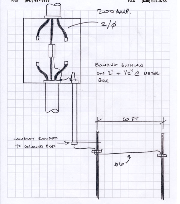

So option #1 using #4 in lieu of the #6 would be correct? I'm assuming the ground to the water main would still need to be #4.
Yes, the GEC to the water main would be sized according to 250.66. Take a look at 250.24(A)(1) and see how it corresponds to your GEC connection to the ground bar.
Concentric KO's would mean that you cannot use bonding locknut's to bond service raceways. A bonding jumper would need to be used with a bonding bushing. If you had a KO punched for the size of the raceway then you could use a bonding locknut. 250.92(B)(4).

Sorry for the confusion, with the multiple changing sketches I'm having trouble following along too. Service raceways require bonding beyond the use of 2 standard locknut's. You can use a boning locknut, a bonding bushing or some other approved methods. A bonding locknut can only be used when the KO is the same size as the conduit therefore a concentric or eccentric KO would require the use of a bonding bushing with a bonding jumper.
What about 250.92(A) it is the requirements of Bonding of Services, see (3)
and 250.92(B) is Method of Bonding at the Service see the note under (4)
At a few of the Western sectionals I have been to, this question was brought up more then once and both times the CMP's and UL said the concentric KO's were not listed for grounding of raceways protecting service conductors or GEC's, and cited the above code sections each time.

Still having a hard time getting my head around this.
Would either of these be correct
Option #1
Meter Can
Panel
or
Option #2
Meter Can
Panel
Option #2 the Panel. You cannot run the EGC from the meter to the panel, you have paralled the neutral. Ground the meter can and stop there.

The only thing that was permitted to parallel the neutral is the service raceway between the meter and panel/service disconnect, because a raceway is not a wire. but because of 250.142 you have never needed a EGC between these two points anyway since the grounded service conductor is allowed to serve this very purpose up to the point of the first means of disconnect. and if we look at 250.92(B)(1) it is one of the permitted ways to bond the equipment enclosures of service conductors, or GEC's 250.92(A)(3)
so since the panel has a MJB, the panel is bonded, since most meter cans neutral lugs are mounted to the can, the meter can is bonded, but the raceway between the meter and panel/disconnect is the only thing left to bond and 250.92(B)(4) clearly states "standard locknut's or bushings shall not be the sole means for the bonding required by this section." we are left with bonding locknut's or grounding bushings, bonding locknut's cant be used across concentric KO's
and since we are only bonding the pipe then it is only required to bond one end.:smile:
Roger did you see in that UL section you quoted where it says "for non-service conductors only" I don't think it applies to the service conductors here?
And the definition of "service conductors" does not include GEC's
