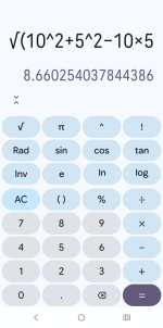

I have not tried this formula yet. But I got this video from another thread. It basically says polar coordinates with sine and cosine and run it through the Pythagorean theorem. I made an ugly spreadsheet and it works. 8.66 amps. Unfortunately I did not make it that far in math.
Can somebody more mathy than I explain if the SOS/SOP formula above is also correct?

Put it all together, and we see the formula is verified:
|Ɪn| = sqrt(|Ɪa|^2 + |Ɪb|^2 + |Ɪc|^2 - |Ɪa|*|Ɪb| - |Ɪb|*|Ɪc| - |Ɪa|*|Ɪc|)
