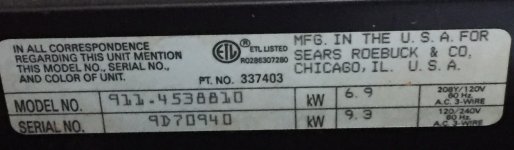

Agreed that ideally you'd find a range with a nameplate saying some like "Voltage: 240/208V" and "kW Rating: 10.0/7.5".
E.g. something like the image below (actually the first image result for my google image search for "range nameplate"):
Cheers, Wayne
