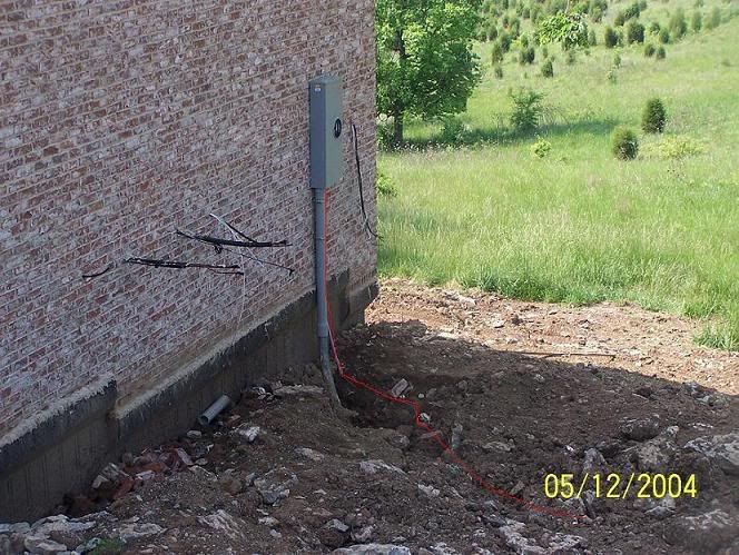

I was turned down on a meter can for 400 amp service due to ground wire size.
I have 400 amp service and I was rejected because of the ground from the meter can to the 8' grounding rod was a # 6, solid, bare ground wire with no splices. I think 250 .66 (a) applies.
Any thoughts on a reason it wouldn't?
I look forward to hearing from you.
Kirk
It only has to be #6, no matter how big your service is, with one possible exception. You need to jump up to #4 if it runs by itself in a place where it might be subject to physical damage. Could that be what their beef was?

(B) Securing and Protection from Physical Damage. A grounding electrode conductor or its enclosure shall be securely fastened to the surface on which it is carried. A 4 AWG copper or aluminum or larger conductor shall be protected if exposed to severe physical damage. A 6 AWG grounding conductor that is free from exposure to physical damage shall be permitted to be run along the surface of the building construction without metal covering or protection where it is securely fastened to the construction; otherwise, it shall be in rigid metal conduit, intermediate metal conduit, rigid nonmetallic conduit, electrical metallic tubing, or cable armor. Grounding conductors smaller than 6 AWG shall be in rigid metal conduit, intermediate metal conduit, rigid nonmetallic conduit, electrical metallic tubing, or cable armor.[/QUOTE]

You're right and the inspector is wrong if you truly have installed the GEC as per 250-66(A) & 250-64(B). The inspector needs to clarify the violation.

Here: 400 Amp service, #4 bare to (2) ground rods, ground wire goes to meter base in 1/2" pvc, ground wire from panel to water main - if copper plumbing.
Inside house - (2) 200 amp panels, bare #6 from each panel to water main copper pipe
