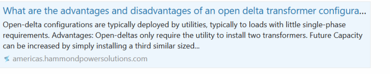

The 5% value is for closed delta transformer wound on a single core. It is not applicable to open delta configurations using separate transformer. Open delta single phase loading restrictions needs to come from the utility.
It's supposedly still a common problem with open delta
"Unbalanced single phase loads can cause voltage fluctuations and additional, uneven transformer heating."
I have to disagree with the information mentioned before even opening that link.
A lot of open delta, particularly 120/240 systems, have large 120/240 transformer for supplying 120/240 loads and have a small transformer to create the "third phase" that was only intended to supply a limited amount of VA to be able to run three phase loads.
If the need is truly for higher power (typically when the majority of load is motors or other high power three phase connected loads) then they generally will go full delta and all three transformers are same size.
A somewhat rare situation is remote locations where they decided to save a little $$ by running one less primary conductor and use an open delta. In that case if you have significant amount of three phase load then you may need to derate the transformers, but they will still get the job done if sized correctly.
One other situation is single/limited load applications. Say a pumping station that doesn't have too high of a VA rating. Those they may opt for open delta to save $ on equipment, but there comes a point where going full delta is still better choice overall if all three primary phases are present. This point not only looks at the VA rating of the load but duty cycle of that load as well. Something that doesn't run all that often may be determined to be ok to go with the open delta where something that runs nearly constantly may be determined is best to be put on full delta.

It's Hammond transformer company, pretty major transformer company.
It seems you may have taken what I said to mean you can't run much of single phase loads, but the issue raised is just imbalance.
That is an FAQ written by a transformer manufacturer that wants you to purchase one of their units. It is written as if they are talking about all open-deltas when thry are specifically referring to high leg open deltas.
Yes, unbalanced loading can cause unbalanced voltages on most transformers. But, properly sized and applied transformers can handle unbalanced loads.
The supposed loss of capacity ignores the fact of the actual component selection. It is not a surprise that 2 is less than 3, but who cares if you only need 1.75?

It is a problem with single core units. Most open delta is made up of two individual single phase transformers. If sized correctly for the load, they are pretty stable. Most of them are POCO transformers but doesn't have to be. What I do see is something that once was sufficient for the load has had more load added over time and now isn't what would be used if doing a new install, particularly when it is POCO transformers. If it is customer owned units, there may be more chance they are tripping overcurrent devices if things are well protected. POCO overcurrent protection is often rather conservative and will allow a certain amount of overloading, even if voltage drops as a result.

Just to clarify though, Hammond was specifically talking about two single phase transformers in open-delta. It's a brief page.
Okay.
Actually they were talking about two single phase transformer where one of them has a center tap.
