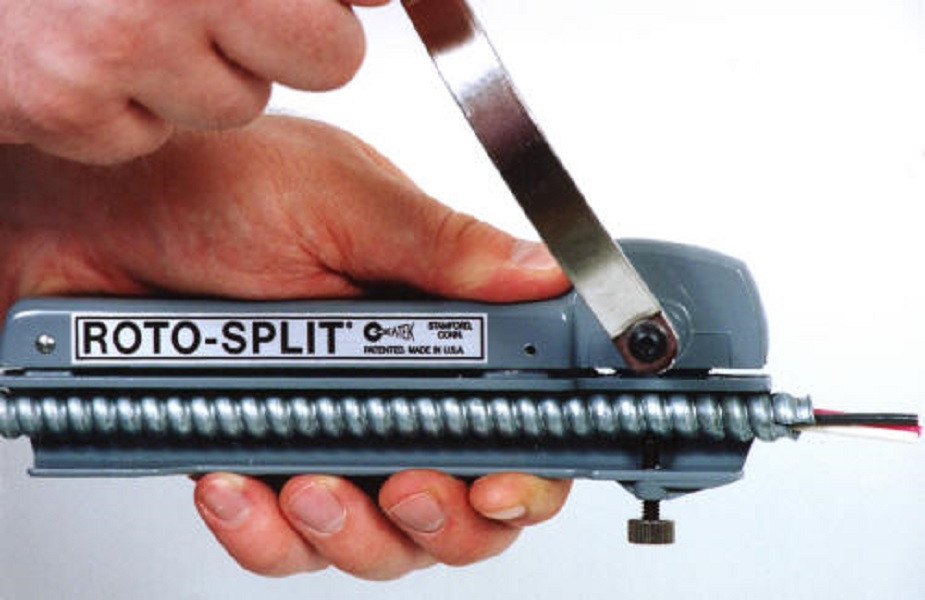

What's the best manufacturer of armour cable cutter?

I would guess that Roto-Split is the best selling cable cutter.

I agree, Roto-Split is probably the best. I just purchased an Ideal cable cutter and I'm having some trouble using it. I think it has to do with the cable size adjustment. It may not be tight enough. As soon as the blade starts cutting into the cable it causes the cable to jump forward and cut the armor in the wrong spot. I'll keep working at it - not ready to bring it back to the supply house yet.

Another vote for Rotospilts but this model with the extra lever
It is better when working with multiple sizes of MC, you don't have to adjust the knob to change sizes. :)
I agree don't use the one in the photo that I posted. ;)

I also like the handle one, I found a stand off screw that you can remove the handle and screw it in then using a 5/16th or 3/8" hex driver bit for the larger ones, put the hex bit in your drill it makes it easier when doing allot of cuts, the standoff screw is the type you use when mounting circuit boards to a cabinet back like they used in older computers,
I hate roto splitters unless im cutting through hard bx cable. Otherwise i use my dikes which is fast and easy especially if your making up a rat nest of a j-box full of MC cable... Roto splits eat up time like crazy and some eat into the sheathing of the wire too much and eat through to your conductors... not good.

I like the Greenlee cutter better. It was the one I used first.
Old habits are hard to break, or is it you never get a second chance to make a first impression?
The Greenlee model is the only one I have used, so I am used to it, but can't really compare to the roto split either. When I worked for another company we had an ideal stripper that wasn't a rotary type, that actually was faster then the rotary cutter, but I think it had less range of cables it worked with - but we pretty much only ran 12-2 and 12-3 and it worked great on both. It was more of a pliers type device - kind of hard to describe, maybe they still make it and I can find a link to one.
Can't speak for roto splitter but the greenlee has an adjusting screw to set the cutting depth, I can't recall ever never needing to adjust it though.
