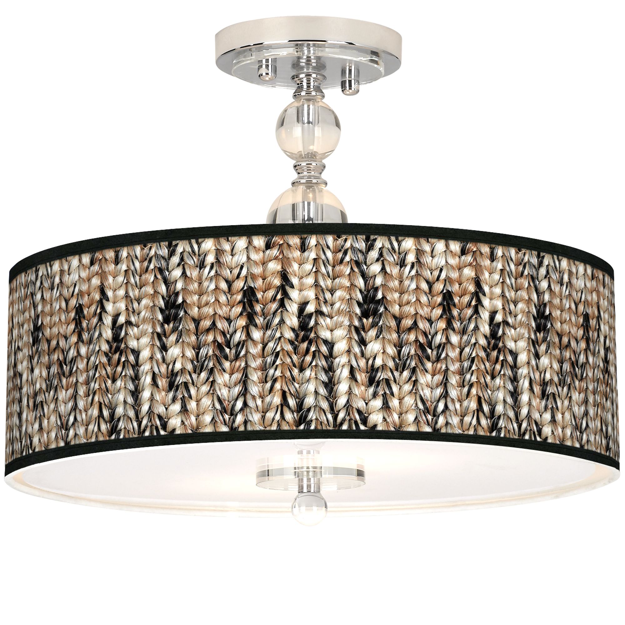

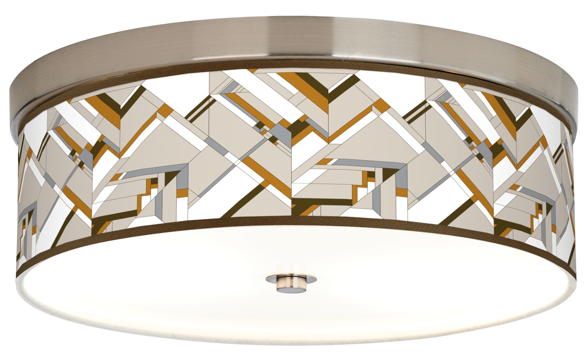

As far as I know, nothing in the code says "flush" when referencing lights
We're stuck choosing between recessed and surface.
But the difference between surface and flush is in how it mounts. There isn't anything allowing a chandelier to mount to a surface.. It has to mount to a box that's in turn mounted. A chandeluer is also not recessed. The supporting bracket of a chandelier mounts flush with the surface.
The OP is asking about a "surface mount" light and in the same breath mentions "hanging"
I don't think he meant surface mount
Yes there basically is just recessed and surface mounted. But surface mounted can include types mentioned in the code quoted in posts 2 and 3 that also incorporate cords, chains, and suspended components off those mentioned items, vs some basic, rigid, close to ceiling types. Those are allowed in the zone and must also be damp or even wet rated if directly over the tub/shower.
Surface mount only includes that which gets mounted to the surface. I don't know why it's got to be like pulling teeth to get people to understand that. It all hangs on the word "mount"
Does It screw to the drywall? Then it is surface mount. Does It screw to a finished block wall? Then it is surface mount. Does this screw to some wood paneling? Then it is surface mount.
It doesn't matter the size, the shape, or anything like that. It matters where it mounts. And there isn't any chandelier I've ever seen that mounts to a drywall ceiling. They mount to a box, that is in turn "flush" with the drywall.
But the light is not "flush" with the drywall, thus it is "surface" mounted.
The light doesn't have to be flush, only the mounting apparatus. That's why the word "mount" is used.
Just like a flush mount receptacle and plate is on the surface of the drywall. But it mounts to a box that's flush with the surface.
James no disrespect but I don't know where you are getting this info. Almost all fixtures in your scenario would be flush. This, imo is not the case
for application of 410.10(D) the words flush and surface don't appear within the code section anyway, it just prohibits use of cord-connected luminaires, chain-, cable-, or cord-suspended luminaires, lighting track, pendants, or ceiling-suspended (paddle) fans .
IMESHO: Flush is flat with the surface and recessed is the same.
Surface the whole fixture is on top of the surface.
Pendant hangs off the surface.
You can call it whatever you want but that's how I define it.
It's interesting that every manufacturer shows flush and semi-flush fixtures along with pendant as choices. Of course, there is also wall sconces and recessed.
Semi- Flush and Flush
