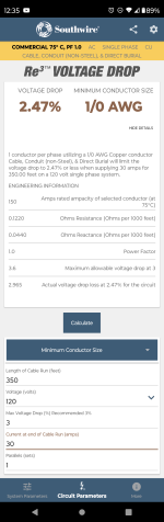

Not sure what your actual load is but for the minimum conductor size I ran these through the Southwire VD calculator and got these numbers for:
120 volts, 350', 3% VD, Copper conductors, (Aluminum conductors):
30 amps-#1/0 (#3/0)
25 amps-#1 AWG (#2/0)
20 amps-#2 AWG (#1/0)
15 amps-#4 AWG (#2 AWG)
10 amps #6 AWG (#3 AWG)
Are you sizing these at a continuous load rating? Is that necessary considering the wire is undergoing derating and ampacity adjustments?
No. It's just the minimum conductor size based on the load listed. There is no derating or adjustments required based on the parameters in the OP.
