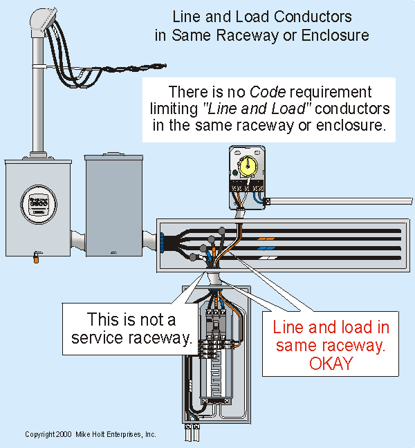

I can't find anything that says I cannot share a branch circuit and it's source feeder in a junction box ,but I've never had to do this before, so I was hoping someone had some experience with this and if it is code.

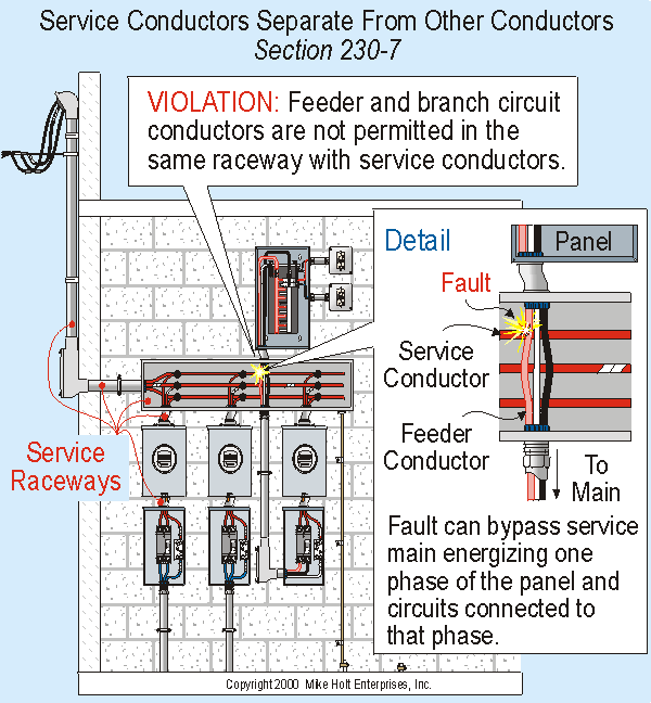

You probably already know this ...but...
If your "source feeder" includes Service Conductors, you can't do this.

Like all those branch circuits in that circuit breaker panel where the service conductors terminate?
That brings up a good question (to me anyway).
Is a junction box considered a raceway?
I'm talking about a junction box that has only cables passing thru it, not conduit.
