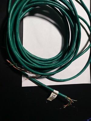

When I see 600V cat5 I tucked in with control panel stuff I am re-doing or servicing I look for a way to re-route and separate it completely.
I have techs argue with me that the 600V cat5 is a permanent barrier and meets the exception 1 in that section:

Real 600V listed cable like Allen-Bradley 600 volt rated cat5 or 6 or whatever, might be considered by an AHJ/508A inspector as meeting Exception No. 1 , as the thick outdoor covering and the 600V conductors provide a 'permanent barrier':

Read the jacket of that CAT 5E or 6 cable carefully. It does indeed state 600 V AWM. Now look in chapter 3 for wire type AWM. This gives all the conditions under which you can use that wire type.
Hmm...seems to be missing!
NEC has a minimum of 18 gauge for chapter 1-3 wiring. Ethernet won’t work on anything that thick. So it cannot possibly be used with general wiring, ever.
But wait you say. AB has smart MCCs. They use that wire. In some MCCs it is literally tie wrapped to the 600 V power conductors. The insulation is thicker than #14. And this is all true. AWM stands for appliance wiring media. It is a catch all term. So if you are AB making MCCs you can use almost any wire you want. AWM means it is customer specific wiring. UL is going to test the final assembly anyway so type AWM is just a pass through. It’s strictly a.component listing so not allowed by NEC.
That same cable is also Listed as PLTC. Under this category you can mix it with other power limited cables, even 120 V lighting, but it is power limited and must comply with those rules.
Ethernet is the most ridiculous example of why the #18 limit is silly. The Ethernet specification calls for an isolation transformer with 1500 V of isolation. The UL/NEC argument has to do with withstanding ground faults but since Ethernet is isolated from ground the argument is flawed but overcoming it would be difficult.
