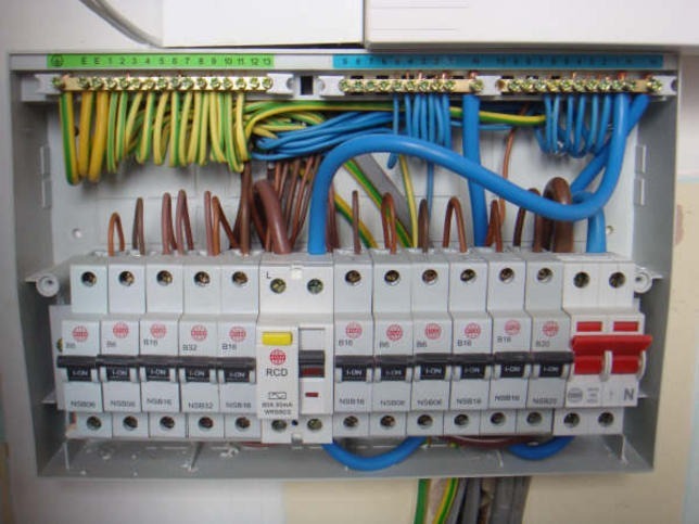

One of this physical size:
Do you have samples of what the main panels (say 16 breaker panel) look like for those countries that use purely din rail breakers? Is it all horizontal? What is equivalent that look like the American plug-in panels (rectangular vertical)?
Yes, here is a British Consumer unit:
One with RCBOs:
France:
prix-raccordement-tableau-electrique-79-fort-de-france-prix-raccordement-fibre-immeuble-cout-orange-pavillon-02321311-oeuf-exceptionnel-maison-gaz-ville-individuelle-neuv.jpg

https://www.youtube.com/watch?v=C3ZU8QlSnVs
Well, if you take a look at this site, its clear DIN rail breakers are just as bad:
http://www.kontrollbuero.ch/fotogalerie/fotogalerie.htm
In the UK its usually 30ma for panels, sometimes less for RCD sockets. This one though is 30ma:
