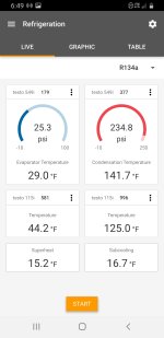

Once your new guy hooks on to system, get him to snapshot the parameters such as what I attached from one of mine. Would also need to know the load conditions such as ambient dry bulb and indoor wet/dry bulb. Basically as much data as possible. But if you have a good tech, they will prob be on the hunt for any culprits, and be all over a repair BUT, I like to save this data so there is no BS about what the issue "was", and how it got fixed.
I've seen countless idiots overcharge equipment because they could not tell on their gauges, the difference between low charge and a bad TXV. Having good service records is important.
