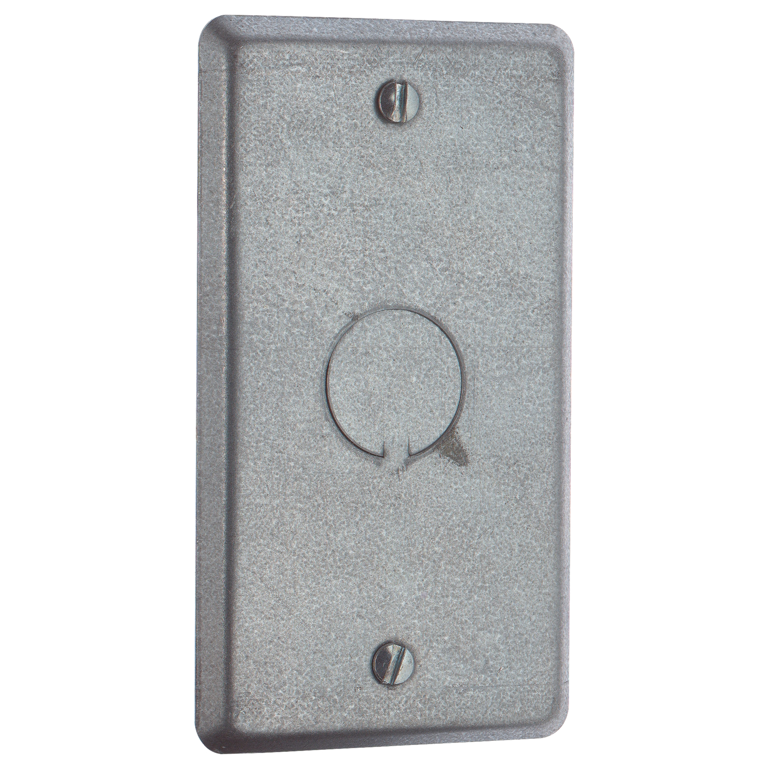

For as long as I can remember all you need to do is have a single gang box blank cover with KO and ba da bing buda boom its done.
Or you can use one of those combo two gang boxeswith a lo vo divider and a cover plate if you don't want the exposed trans.
What is the difference between doing that, and putting the tranny in a KO on the panel?
As long as the exterior of the panel is exposed, it's no different than a KO-mounted surge protector to a panel or a RIB to a box.
The cover-with-KO would be used on a flush-mounted box, typically in a closet near the front door.
