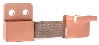

When you connect bust duct to a breaker in a piece of gear does the copper bus on the bus duct connect to the cooper bus in the gear? No wire connections? Sorry I can't change the title....I see the spelling errors.

The bus connection is often done using flexible bus links rather than rigid bus.
